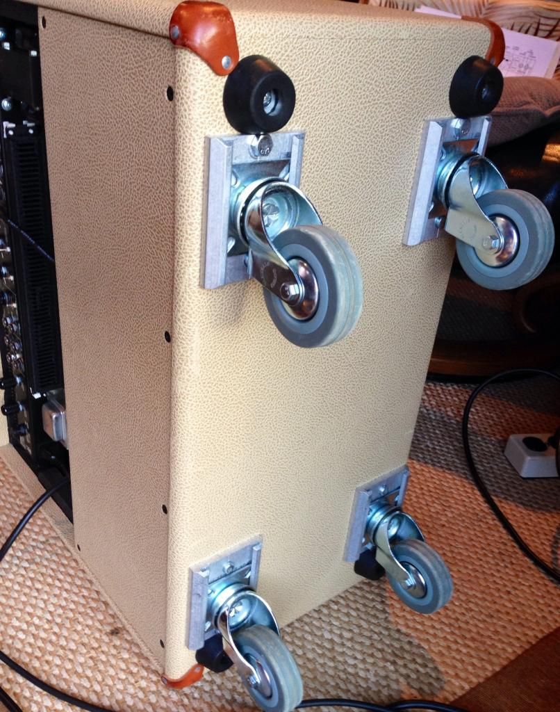

Aloha All,
I spent many hours scouring the internet and finally found some rubber 3" casters with the right size swivel plate to fit the Mesa Track-Loc plates. I didn't want the hard phenolic wheels, which rattle and shake your tubes while rolling over crunchy parking lots, beat up sidewalks, and bumpy thresholds.
This may be a covered subject, but I didn't find anything searching this forum.
They are from Grainger, available online, and really improve the ride! Here's some pics:

Nice. Do you have a part number or description? Also, are the Track Lock plates available for purchase anywhere else or are they patented by Mesa?

In the interest of saving the next person some valuable time. Here are the part details for the rubber caster from Grainger. It took me a bit to find it buried within the hundreds of different casters they have. The key is the plate size, which for Boogies, is 2 3/8" x 2 3/8".
Brand: Revvo
Item # 16D123
Mfr. Model # TSED 075 RN0D
UNSPSC # 31162701
Wheel diameter: 3"
https://www.grainger.com/product/REVVO-3-Swivel-Plate-Caster-16D123

In the UK these fit and are cheap
https://www.castors-online.co.uk/acatal ... ixing.html

Turns out Wallmart sells them now and not too expensive. Online only.
https://www.walmart.com/ip/REVVO-TSED-0 ... a/40786597
