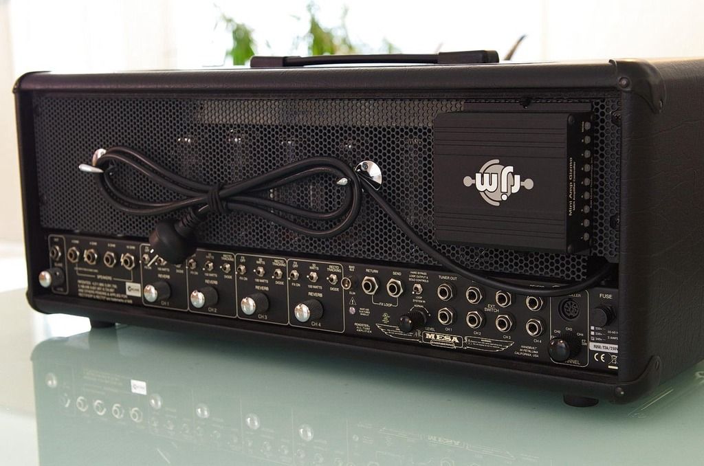

dlpasco wrote:
Working on my gig rig and just wishing that Mesa would drop a Mark V update with the JP-2C features. ESPECIALLY MIDI CONTROL.
At the moment I'm trying to figure out how I'm going to fit a mini amp gizmo (which I do not own yet) on to my pedal board. It's looking grim.
PS: Midi-selectable channel modes would be hot.
Here is my RJM unit cable tied to the metal screen. I connect the proper cable (RJM cable) when needed between the Gizmo and the amp's switch jacks. I think I need to attach the cable permanently by tying it down with cable ties rather than connecting / disconnecting.
Something you may want to consider for you setup (I'm assuming your pedal board is away from you amp):
With the Gizmo attached to your pedal board, the RJM cable will be a long run back to your amp. Considering the RJM cable is 'specially made' I'd protect this cable as priority and keep it as a short run by attaching the Gizmo to the amp instead, similar to how I have. Having the Gizmo attached to the amp the RJM cable is short and tucked away. You only need to run one standard midi cable from your pedal board to the Gizmo. A standard midi cable is a lot cheaper if it get's damaged with overly excited feet.
RJM unit cable tied. Power lead shown with hooks that I installed. The hooks are simple clothes hooks I bought from a hardware store. I don't understand why Mesa doesn't have hooks to wrap the power lead nice and neat. My Peavey JSX has moulded hooks as standard.
Gotta love tubes!
If you're interested in the chicken head knob replacement on my Roadster amp, go here:
viewtopic.php?f=24&t=69901&p=476098#p476098
