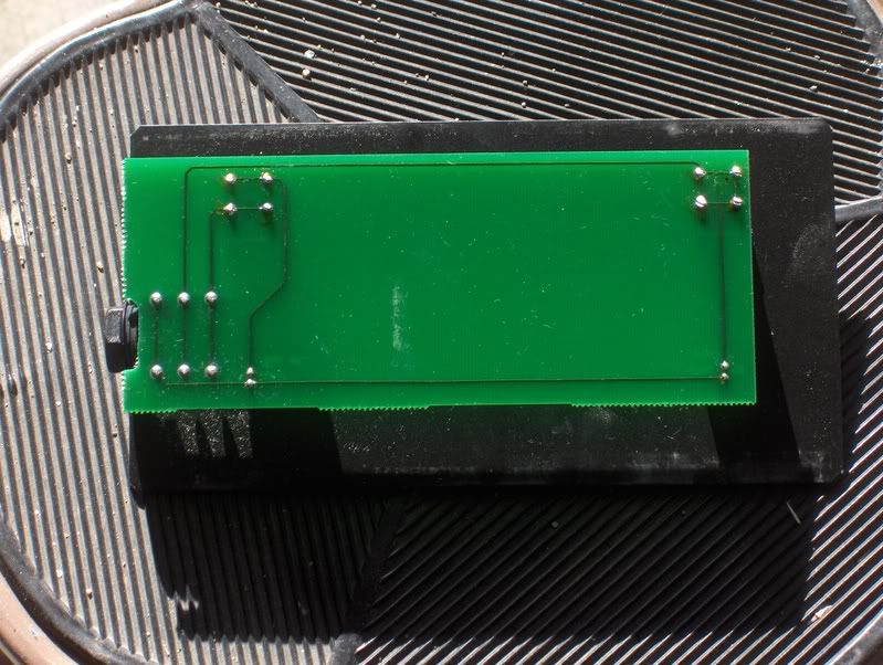

I still don't understand this footswitch connection and can't get it to work. When I review the schematics for the footswitch at schematic heaven it shows MESA drawings which show a standard 1/4 stereo plug wiring with the long part of the plug being ground. Yet in the Lonestar manual they keep calling it "tip to ground" Does that mean literally the tip should be ground. If so than their own schematics are wrong. Could someone take a picture of the inside of their footswitch showing the wiring? That would be most appreciated. Thanks!

Here's a gut shot. (LSC footswitch)

Thanks for the help plan-x. Appears like its what I expected. Tip & sleeve are (+) or "functions" while the long barrel of the plug is (-) or ground. I assume the topside of the board is just the switches, jack, and LEDs soldered to the board. I measured the voltages by inserting a stereo cord into the F/S jack in the front. I got 12 V off the sleeve and 11.37 V off the tip. I'm wondering now if something is hosed on the inside?
