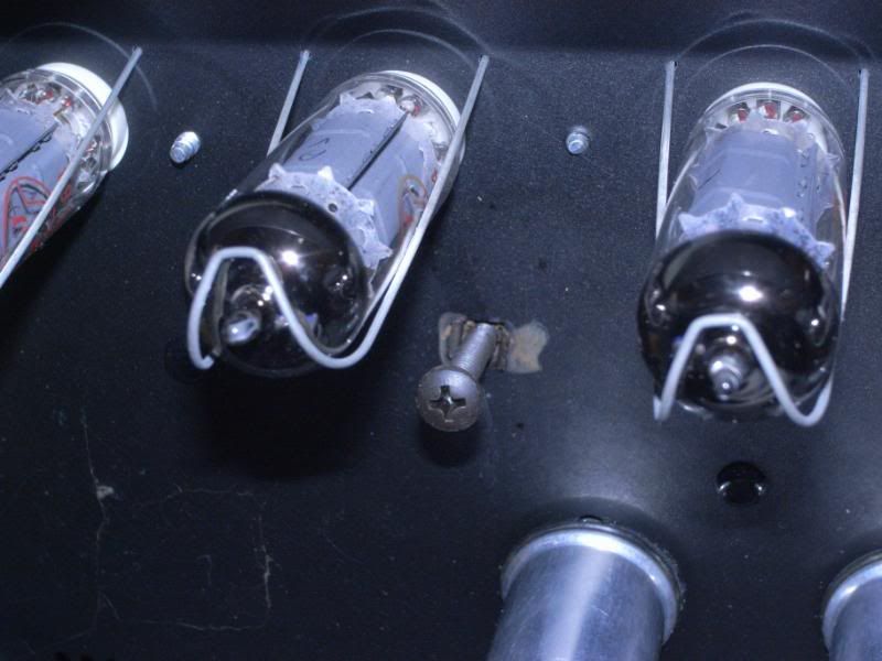

The screw in question.. just to clarrify... :)
on second pic, you can see the top of the screw has a grounding plate to make good contact with the shielding above.

How hard was it to remove the chassis? I'm thinking of trying to repair my "screw" up (pun intended) by replacing the screw and putting some wood putty into the underside of the cabinet where I undoubtedly chewed the heck out of it overtightening that screw!
What does that screw push against? Right into the wood of the cabinet or is there some kind of plate or something there?

dougbilski,
I just found that pic on the web when researching what the screw does, not had my chassis out. so Im not qualified to help, other than presume the top of the screw tightens against a foil sheet on underside of the cab top.

Thanks for clearing up the mystery on this screw for me.
Here's a shot of one sticking out of my Rocket 44:

1028paul wrote:
... the top of the screw tightens against a foil sheet on underside of the cab top.
Paul.
That is correct. The screw should just be snug. Do not over tighten. Note you need to loosen this screw before removing the chassis, from the cab.

Does anyone have any info on this screw? My amp is missing it. I left a mesa with Mesa Tech support with no reply.
It looks like a #8 or #6 (32) coarse 3" screw. Can anyone confirm this.
Also, how much damage to the foil shielding would have to be done to warrant replacing it? there looks like there may be a few small tears (1/8") where someone over tightened the screw.
Ive read some people use screen, aluminum ducting sheets, or plain BBQ foil. Anyone have any experience with any of these materials?
