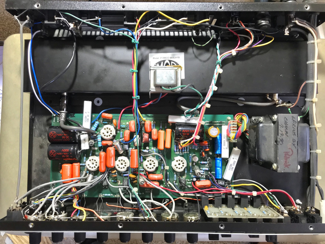

For those curious, here is how she turned out. I know, some of the 10w resistors are overkill and too big, but their leads are insulated where needed and they work great. Yes, I fit a full size reverb tank in there: wired in parallel with the original smaller tank like the Quad Preamp. The reverb transformer and small tank are attached with 3M double sided tape. Position didn’t seem to matter regarding noise.
