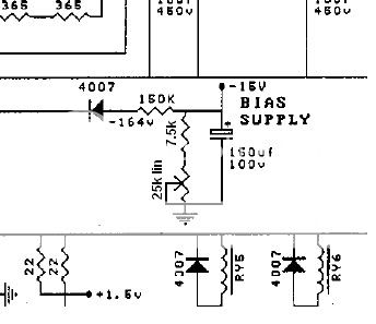

Hello fellow brave Nomad owners. Not seeing a bias mod here and seeing some requests I'll post my best guess. Now, the mod I did was not for the faint at heart because I drilled some holes in the chassis. You can accomplish the same thing w/o destruction with some thought. I did this for three reasons: (1) I bought a matched quad of 6L6's off my friend who owns a music store, in lieu of Dougs Tubes, The Tube Store, Eurotubes or Mesa, and, of course, they ended up colder than a gold diggers ass in the Klondikes - like nearly half power. (2) I gig frequently, I carry spare tubes and parts, and I needed a way to change tubes on the fly without tearing my amp apart. (3) With all the Nomad bashing and seeing the resale value of Nomads go for 50% of the original retail price, I'm relatively sure I'm not screwing up a future collectors item. I have a Nomad 100 2x12 combo which is a real ball buster and a PITA to work on.
Bias section before mod:
Power section before mod:
Bias section after mod:
Power section after mod:
What I was going for was a way to adjust the bias without removing the feature of being able to switch between 6L6 or EL34 and this is why I selected to remove the 56K resistor and replace it with a 33k safety resistor and a 50K pot. Some quick calulations told me this would meet the sweet spot of most output tubes. The 1 ohm, 1 watt, 1% resistor installed between the 6L6 cathodes and ground is a way for me to measure the amount of cathode current flowing though all four tubes. I just plug my voltmeter across the resistor and mV = mA. This is the same priciple many bias probes use except they usually measure one tube at a time. I was thinking about using a 1 ohm. 2W, 5% resistor for a safety factor, but, after testing, the max dissapation of the resistor will never get above .5 watts and I like the presision of 1%. I mean, if the resistor does burn at 1 watt, which would mean the amp would be trying to pump out 400+ watts, I hope it would burn up and save my output transformer!

My bias problem started when I was pressured by my friend to buy tubes from him - you know, support your local businesses, buddies and all. Those JJ's were so cold that they were definately into crossover distortion. The only saving grace is that most of Mesa's tone comes from the pre-amp section. So the cold tubes were not that noticable in my amp to everbody else. Mesa runs their power section so cold and clean that you need to ram the amp up to 6+ before any kind of power amp distortion occurs. You have the extreme switch which will definately get the output cooking quicker. After I did the mod - wow - harmonically rich tone instead of cold and sterile.
If you buy tubes from Mesa you are golden. I just don't like the Chinese crap they are pushing right now. If you buy tubes from Doug's Tubes, The Tube Store or Eurotubes and tell them you have a Mesa Nomad 45 they will set you up with tubes that are within Mesa's window of operation. Alas, the pitfalls of fixed grid bias.
You've got an EL84 amp so your bias mod would look something like this:
If you wanted to try the 1 ohm cathode resistor on the power tubes, the procedure would be similar to the one I've shown. 1) Find the gound jumper to the power tube section. 2) Remove it. 3) Insert the 1 ohm resistor where the jumper was.
If you look at the schematic for the Nomad, the channel one send and return circuits contain nothing to knock down the signal while the channel 2 & 3 sends contain a 120K series resistor on the input and return contains the 330K series resistor. Both of the resistors beat the signal way down while using reverb on channels 2 & 3. I've never stuck an o-scope on it, but somebody at Mesa must have thought the signal swing was too large at this point. Some people don't like the ringing/twanging sound when a high gain distored signal hits the reverb. To my ears, you could barely tell the reverb was even on channels 2 & 3. You can see if you increase the gain of the reverb input buffer where channel one would try to hammer the reverb into distortion while channel 2 & 3 sounds good. I would leave the .02 orange drop, remove the 330K across the 475K and use the mod I've shown. If the distortion persists, especially when bassy notes are hit, lower the value of the cap until you like it.

There are a pair of 1N4007 rectifier diodes in anti-parallel strapped to the input of the opamp stage that drives the reverb. You see the same setup in dirt pedals, granted typically *after* an opamp stage, as a guitar signal is typically too weak otherwise. I suspect they're they're to act as limiters to prevent the opamp itself from being overdriven, which probably sounds worse than a pair of clipper diodes.
If I'm understanding the rest of the circuit correctly, the opamp stage is configured for a gain of 10, and has power rails of +/-15V, which theoretically means the output signal of the op amp could swing 30V peak-to-peak before running out of power from the power supply and clipping. At a gain of 10, that means an input signal of any greater than 3V peak-to-peak would overdrive the opamp. However, in all the simulations I've run of opamp amplifier circuits, the opamp cannot take the output signal all the way to the power rails - it always clips a little bit before. So then lets give ourselves 20% headroom, and try to avoid feeding the opamp a signal it would try to take past 24V peak-to-peak. With a gain of ten, that limits us to an input signal of 2.4Vpp. Those diodes limit the input signal from going higher than 1.4Vpp.
So if we are clipping the diodes we could increase the number of diodes or replace them with diodes with higher forward voltages. Unfortunately more silicon diodes means working in multiples of .7V. We could add two more 1N4007s, but that means now peak input voltage can reach 2.8Vpp. At a gain of 10, output voltage would be 28Vpp, almost 95% of the power supply voltage, putting the opamp pretty close to clipping if it isn't clipping already. A red LED wouldn't work either for the same reason. 1.6V on each red diode would mean the opamp could see as hot as 3.2Vpp signal on it's input, definitely enough to overdrive it.
1N4007s are rectifier diodes. They're intended for use in power supplies, and as such are intended to withstand high voltage and high current without melting. Assuming those 1N4007s *are* there as limiters to prevent the opamp from being overdriven, I wonder why the limiters need to be able to handle 1000V of reverse voltage. Assuming that the 1N4007s were selected for tonal reasons, then perhaps some germanium diodes could be used here, which have about a .3V forward voltage. If 3 germanium diodes were put in series each way, that would allow 1.8Vpp before the diodes clipped, hopefully giving channel 1 enough headroom to not be clipped by the diodes, but still not driving the opamp so hard as to clip it.
Re: nomad mods
Interesting thought Koreth. Somebody break out the oscilloscope.
