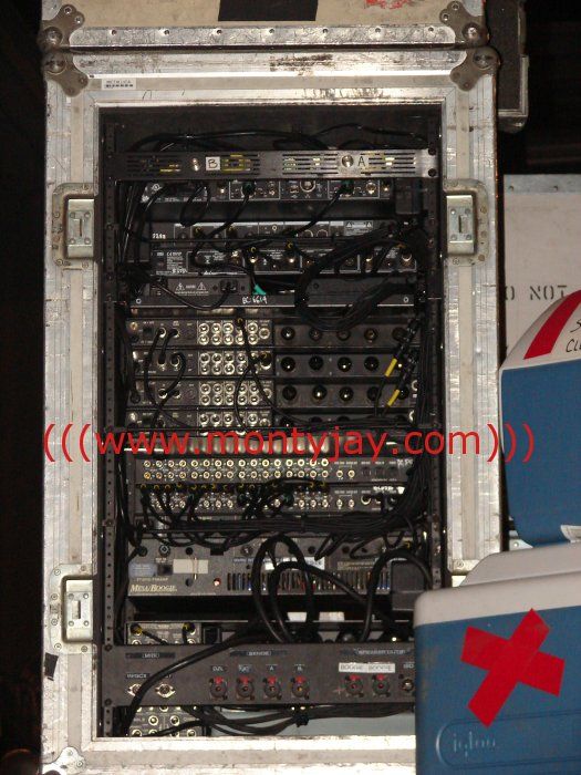

This is the back of James's rack, here you can see that his Triaxis used for his clean sound is using one of the two outputs for his signal and the next one down is his heavy tone Triaxis where the output bring used is the send from the effects loop. I have a Triaxis and a 2:90 power amp so I know the connections on the back well.
From look at schematics of the Mesa Mark IIC+ eq is after the preamp stage like the effects loop, so that is why James has his output for his heavy tone the effect send.
