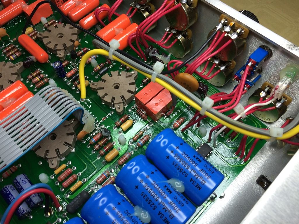

I would put some pictures of the modification that I did but until now I wasn't able to figure out how to upload the pictures, I guess I need to have them on a website and insert the web link to them, I will try later. The fact is that after he modded the Lonestar Head (short head), I modded my Lonestar combo the very next day. Because I A/B them and I couldn't believe my ears the difference. I mean, it is a difference like from unusable to heavenly. That's how serious it is. The beauty of this mod is that it only mods the drive channel. The bad thing is that the capacitor is in a position that requires either taking the amp apart and lifting the main board OR simply cutting the capacitor legs and soldering the new capacitor to the cut legs that remained on the mainboard from the previous one. Sounds worse than actually is, it took me 10 minutes to do it. But it's worth the effort. I know a guitarist that uses the Lonestar Classic on stages and he complains about the bass being almost unmanageable at volume. That's weird isn't it?

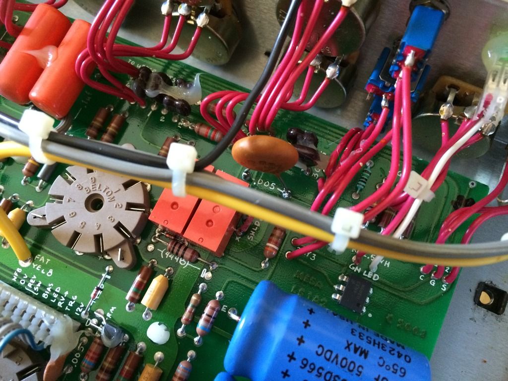

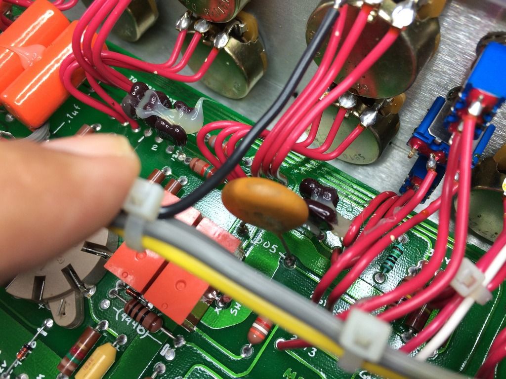

Pictures
The original capacitor was of the orange tube like type that you can see in the pictures.
The new capacitor is ceramic.

No, the disc shape pale orange capacitor that you see in the above pictures is the capacitor that replaced the original.
The original looks like the other bright orange tube like capacitors that you can see around the disc shaped one.
Indeed, the value of the original capacitor was 0.005uf or 5nf if you will. That got swapped with the 1.5nf disc capacitor.
This is not polarized.
