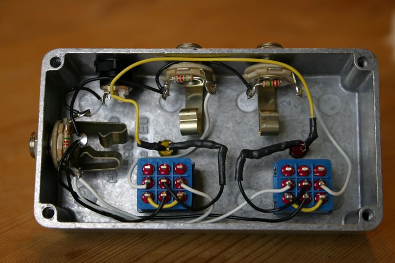

I had a Peavey Valve King that would drop out momentarily upon ch switching. Maybe it had some sort of ch switch muting. If that was the case, I dumped that amp because of that.
I saved an ABY pedal switch design I found on the web because it incorperated a resistor on the jacks to absorb the pop. Take a look. Maybe these things will help you piece the puzzle together.

plan-x wrote:I had a Peavey Valve King that would drop out momentarily upon ch switching. Maybe it had some sort of ch switch muting. If that was the case, I dumped that amp because of that.
Yeah who knows, it might have been muting for too long a time. Thanks for the pic, it seems to use 2.2Mohm resistors across all jacks. Those resistors do help against leaking DCV from other units which heave leaking input and/or ouput coupling capacitors. DVC on the switch would cause a pop.
