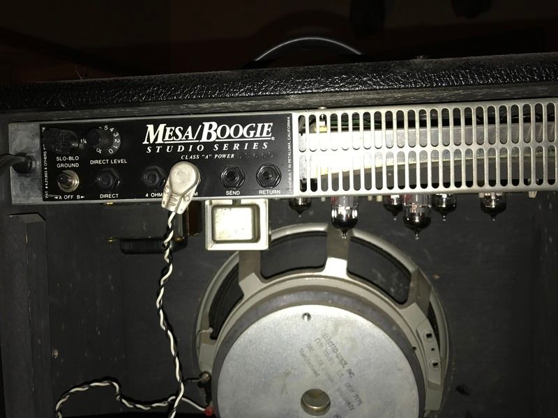

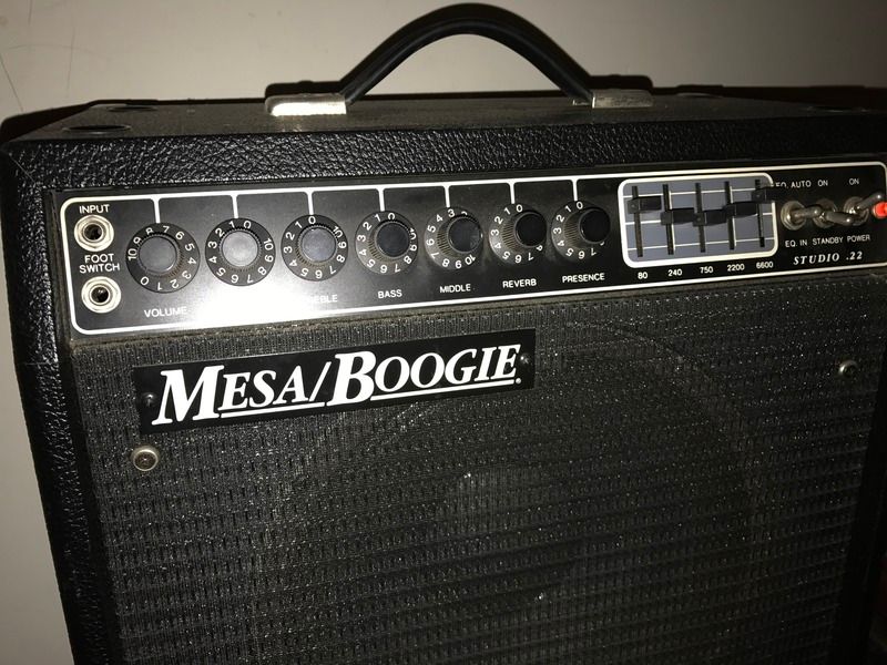

Post by Mopar196973 » Sat Mar 04, 2017 2:05 pm
Newby here ....the Mesa is different than any amp i ever used before.
Can any one explain the tone controls on the studio 22? I acquired one and can can get some awesome clean tones but can't quit dial in the overdrive. The controls area little different than anything I've used before.
It is different how the treble impacts the gain.
How do the combination of the push pull volumes work together?
A lot of subtle interactions with the knobs.

You could post a few shots of the guts of the amp under the chassis to get an idea of what's been done to it.
The switch i ordered should be here tomorrow i will see what it does and will post up a gut shot.

You can activate the lead channel with just a speaker cable. Plug one end into the footswitch jack, and ground the other end to the metal handle cover. You may have to tape it in place, but it will work.
Try these settings:
Volume: 5-6
Master: 5-6
The volume and master interact. You can dime the colume, but the master has to be set fairly low. OR you can set the master up real high, but you have to keep the volume no higher than 3 for a Santana tone.
Treble: 8-10 (higher treble = more saturation)
Bass: 0-2 (higher bass = flubby farty)
Middle: 5
Set reverb and presence to 0, and turn off the eq until you get the best sound with the tone stack.
You can set the presence and eq to taste after you get the sound you like. The eq can suck the tone out, in my opinion. I never use mine in my quad, and my .50 caliber is your amp with twice the power.
