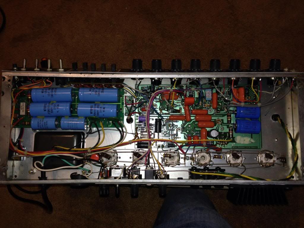

I've posted in a few threads lately, but I need some quick help. I recently found a Boogie listed as a "Mark IIC+ Coliseum" online. I called and asked tons of questions when I spoke to the sales guys, but they couldn't really help me at all, so I arranged to purchase the amp with a money-back-guarantee, in case something didn't check out.
My amp arrived, and I was eager to open up the chassis and check to make sure it was in fact a Mark IIC+ Coliseum. The circuit boards and most of the capacitors appear to be similar to my Mark III Blue Stripe Coli. See below...
Here's the side!
Here's the inside gut shots...
And here's the underside of the chassis...
I'm a little upset because I spent quite a bit more than I normally would (okay, a LOT more than I normally would) on this amp, and I just need to accurately identify this Boogie, and then try to get as much info as quickly as I can.
So, I think I need to start with the following questions:
1. Is this a Mark IIC+ Coliseum, or is this Mark III Coliseum? It doesn't match the pictures I've seen of other IIC+ Coliseums pictured on this site, and it looks really similar to my Mark III Coliseum.

To me it looks like a Mark III Simul Coliseum Amp! Push/Pull Poti on the Mid Pot. Also if i do remember right the IIC+ Coliseum has the RP11A Pre Amp Board on mine. These looks diffrent from the one in yours. Blue pilot light (also mine has also a blue pilot light because it's one of the last IIC+ Coli's). What's the serial on this?
I remember the last IIC+ Coli should have K422 (not counting the IIC+ Coliseum Amps with 5 digit serial number).
Maybe some other member's share some of their knowledge.

Looks like a MkIII Coli to me
Spongerob is correct on the pre-amp board.
Take a look at the faceplate too. If it has a "Pull Rhythm 2" over the Middle knob it's a MkIII
You could also look for the "Limit" knob on the back. Only IIC and IIC+ Colis have the "Limit" knob.
KDRG indicates a Simul Coli which is another indicator.
K=Coliseum, D=Dual Mode aka Simul Class, R=Reverb, G = Graphic EQ
Saying this is an indicator as I'm pretty sure no Simul C+ Coli's were ever made.
The only Simul Coli's made were Mark III's
Lastly the date of 9/85 written on the underside of the chassis indicates it was made after C+ production had stopped (which was ~March of '85).

Thanks Spongerbob and gts for your responses. I agree, this Coli is missing the RP11A Board, and all the boards match my other Coliseum's circuit boards which identify it as a Mark III. Unfortunately, I had to buy this amp "sight unseen" because the seller could only send me a pic of the front, and he claimed it was a IIC+ upgrade, and I know that Mesa ran out of the C+ faceplates, so the old Mark III faceplates were used instead.
Thanks again for your guy's responses! You have confirmed my suspicions. This is still a great amp, but I think I have overpaid for it. Do you guys (or anyone else) know what a reasonable selling price is for a Mark III Coli? I haven't seen one listed for sale in a while, and I'd like to know what the current value would be, and what the last one you saw sold for.
BTW, the serial is K533.
