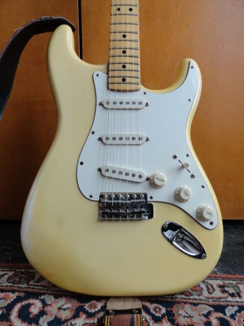

It sounded the way I think a Strat should. Bridge pup was bright but tamed (it runs wide-open as it's not connected to a tone pot...yet!). Very listenable. Mid and the 2 & 4 positions are my favorite with this Strat, and the sustain was perfect: not too much or too little. Rhythm was articulate yet "comforting" as a snuggy :) , but authoritative. But it was the "voicing" in both rhythm and lead (especially lead!) that made me not want to pack up my gear. My friend too. He recommended not changing anything, and I will exercise patience....begrudgingly...or at least until I run my LP through it. At home I thought the LP sounded a bit dark. It's a Guitar Center version of an "R0" Plaintop 1960 reissue ("G0"). Vintage impedances, but with pull-pots for coilsplitting each pup and phase reversal. Very cool guitar, and somewhere mid-stream in terms of eq voicing. I'll take it to rehearsal this week and see.
