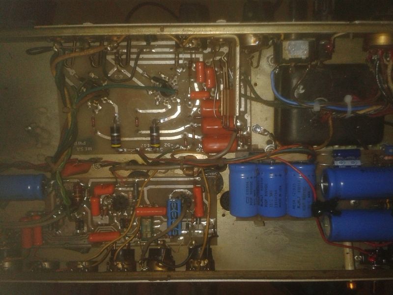

I got my hands on a 1979 blonde mk ii a. This thing seem to be having work done on it, and i am having a hard time getting it back to its original.
Anyways, i got this problem with some of the ceramic caps. They are very microphonic. One in particular - right where i got huge noise problems ( https://www.youtube.com/watch?v=S6dCgj8c9ZM ).
So i'll try and replace it. Im struggling with the code on this thing. Please see my image. It says: "Z5U - .002M - 1KV".
My first thought was a .002 microfahrad. But via google it looks like its a .047microFahrad.
Can anyone confirm this?
I am writing a loooong article on this amp since it looks very modded and to me it looks like bad amateur work.
Here is my image (click to see. Too big for this forum):

First off, you have a lovely early Mark IIA, not a IIB... Very nice amp. Looks like someone has changed the cathode bypass caps but otherwise the circuit looks untouched. With that said, the ceramic cap in your picture is the for the lead channel bright switch. It is a .002uf... It does look a little chewed up from someone flexing it out of the way to solder in the bypass caps. You can swap it out with another ceramic of the same value and same voltage handling. On a side note; those cathode bypass caps look a little chunky to be low value. What are they? They should be no more than 25uf. Mesa started to use the solid tantalums around this period for preamp cathode bypass so that would be a nice touch to restore back.

Thankyou for your reply. Are you 100% sure that it's a M-II-A? Can you perhaps tell me where it's pretty obvious when comparing the II-A and II-B?
I am trying to restore it back to it's original shape. I bought it as a II-B, so this really surprised me.
Which cathode bypass caps are you talking about? Can you perhaps point them out on this picture(if you cant see the whole image, right click and save it - then open it):

Going over the schematics for the mk2a, it seems this is actually a mk2a. I do not know if this is good or bad. The thing sounds fantastic, besides from the noise.
@lovetoboogie, i've been checking out those cathode bypass caps. They do look like newer ones. Does anyone know how the original looks like? Google gives me nothing;). They are coming off pin 3 from the preamp-tubes. The value are the same for both: 220uf and 35Vdc. According to the schematic (and i may be wrong since im no magician i this;)) the values should be 22/25 which i can only guess means 22uf and 25Vdc.
Is this right?
According to uncle doug from Youtube and the ampbook link, the optimal value should be around 25uf.

yes....those will need to come out. Where appropriate for a particular Mark series model, the preamp cathodes, pin 3 & 8 should get 22uf bypass cap. In the pictures you provided I count 3 of them that are incorrect. They are the blue radial electrolytics. You should replace those with something like this;
http://www.ebay.com/itm/12-Kemet-T332E2 ... SwrklVG~nm
On V1 of your amp, the input stage, you have a switchable cathode for what was called a Fetron. That would be the dead giveaway that your amp is a IIA as oppossed to a IIB. In any case, you have the correct cathode bypass cap and transistor arrangement on that cathode(Pin 3) so you can leave that.
I see you have a hum when the lead channel is engaged... lets get those preamp cathodes changed out and then we can address the noise(s)...and the reverb...
You will notice on a Mark IIA in particular the preamp cathode for V2b, pin 8, is not bypassed with a capacitor. That is correct so leave that....
I also see the electrolytic was replaced for the low voltage switching relay... Or at least it looks like it. It would be that black radial capacitor sitting behind the lead master pot. Let us know what that capacitor is and where it's terminating at...
Great pics by the way, very helpful! Welcome to Boogie-Land!

Got my hands on some 22uf@25Vdc today. I put them in there. Didn't change anything. Perhaps the tone and dynamics is better now. Haven't put my Strat in yet. The noise is still there.
I still suspect those old ceramic caps. If i tap on them they are very microphonic which they shouldn't be right?
Im getting a Fluke 177 this week. I am planning to measure every single cap in the preamp section. Just to make sure. If you saw my video on youtube, you'll notice the noise is on the lead-section. So i'm pretty sure that the error is in the preamp-section.
I might end up re-soldering the whole board at some point.
I checked up on Ceramic caps. Seems that noone makes those brows caps in 1KV anymore. They are blue now. Can i use these newer blue ones you think?

Actually, i found another wrong cap. Across V1a pin 3 - should also be a 22uf, but appears to be 100uf. I wonder who the heck did this. Has he no respect;-).

you are working with a circuit that has been modified. troubleshooting includes putting the circuit back to stock as you indicated you are interested in doing. ...
the hum on the lead channel is being introduced when half of the V3 preamp tube is engaged. so you start by changing that tube to a known good 12ax7/ecc83...
after that or subsequent to, you take plate voltage measurements off of V3 pin 1 & 6 to ensure the stage is being fed, check the lead drive pot and it's switching matrix to ensure the channel switching relay is engaging both sides, check the low voltage feed to the relay to make sure that is fed and filtered,... since you have no hum on the clean/rhythm channel which shares its B+ filter cap with the lead channel, you can eliminate a bad filter cap...
if you have an audio probe and signal generator the hum can be isolated often in minutes. a DMM should get you there....
dont fixate on the ceramic caps... they are unusually durable. although noisy and some can be problematic, there are 1000's of Boogies around the world sounding amazing loaded down with ceramics... ;)
there are many NOS ceramic disc capacitors in all values and voltage handling online. they are still used today in many applications so there are current production offerings as well...a simple google search yielded this:

I did swap the tube in V3. Didn't change anything. I do pay attention to what you recommend;-). So this evening i sat down with Uncle Doug (youtube) and went through all the basics. He is so good at learning. Also i got my Fluke177.
So i've been reading the plate voltages on all the preamp tubes. And either i am doing it wrong, or the voltages are totally off.
Here are my results (in Vdc. numbers in parenthes are voltages according to schematic):
V1A: 252 (144)
V1B: 233.7 (144)
V2A: 254 (258)
V2B: 394 (same as v2a?)
V3A: 259 (cannot see on schematic 50v?)
V3B: 98.7 (250)
V4A: 386.7 (356)
V4B: 386.7 (356)
V5A: 294 (cannot see, 80V on cathode?)
V5B: 285 (cannot see, 80V on cathode?)
