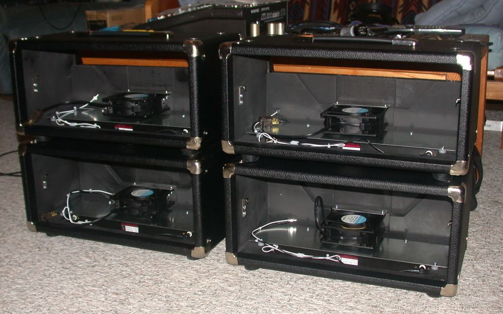

megavoice wrote:
I'm baffling, where did you place the fan ???????
Here's pic of some I made before the chassis went in.
It's easy to see the fan placement etc.
PostPosted: Fri Aug 08, 2014 3:38 pm
Joined: Wed Nov 04, 2009 9:03 am
Posts: 177
EXCELLENT !!! :D
