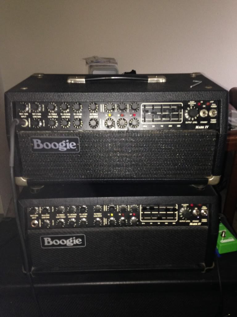

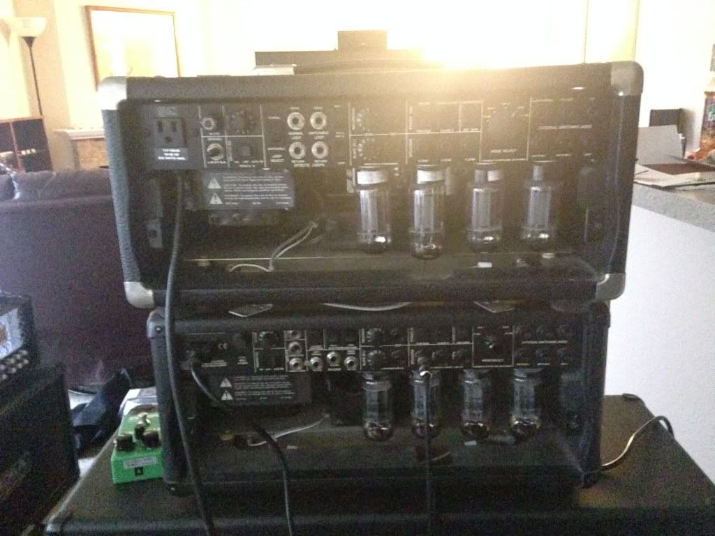

hey there,
new to the forum and I just picked up a Mark IV last week.
amazing amp! so far I was able to play it only at bedroom levels,
but even pretty quiet it does sound incredible.
apparently it's a pretty early on, too.
does anyone know what the jack in the last image is for?
Re: The Mark IV thread....!!
No, but congratulations on the amp!
