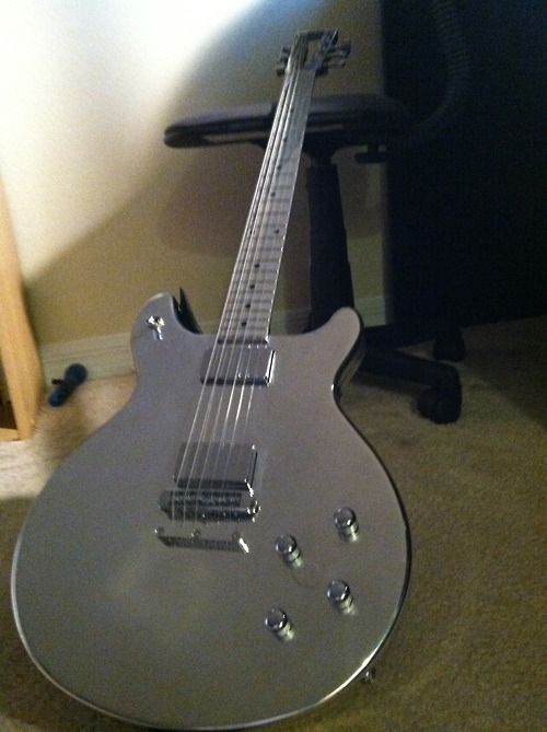

Post by screamingdaisy » Mon Dec 14, 2015 9:28 am
http://www.electricalguitarcompany.com
I don't know much about them beyond what King Buzzo's said in interviews. What stood out was that as a guy that tours constantly he really liked the neck stability.
